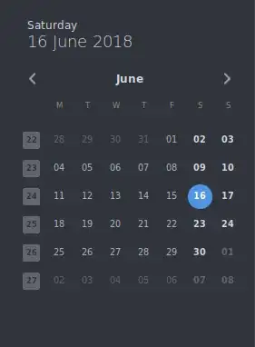

Everyone is asking how to make Monday the first day of the week, here I am stuck with it unable to change it.
I tried already changing the lines in /usr/share/i18n files but no luck and doesn't seem to change anything.
gnome system calendar
