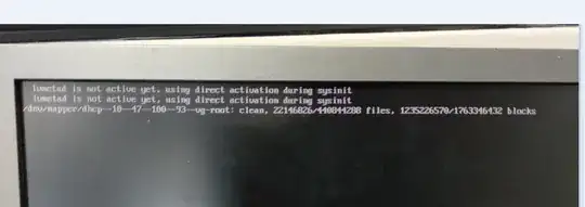

picture Getting lvmetad is not active yet , using direct activation during sysinit
/dev/mapper/dhcp--10--47--100--93-vg-root:clean
We are able to boot through bootable USB.
@David Foerster Actually this is server pc , I don't know what has gone wrong .Any solution to recover other than reinstalling.

If you keep running into errors, boot-repair, has solved quite a few of these issues for me. Might not be the fix but is worth a chance in my opinion. If you're unfamiliar, from your live USB:
sudo add-apt-repository ppa:yannubuntu/boot-repair
sudo apt-get update
sudo apt-get install -y boot-repair && boot-repair
boot-repair
