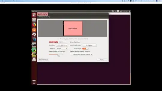

I am running a Ubuntu 14.04 on my VM at work. I have installed Ubuntu Desktop and nomachine server.
It was a quick installation. I connected to the server using nomachine MAC client. And the desktop was there. It was all working fine, until I realized, Ubuntu 14.40 doesn't come with 1920 x1080 resolution by default.
I have a constraint -> I cannot upgrade Ubuntu. It's a setup at work, I have to use it.
1176 x 885 is the maximum resolution I get.
Screenshot
The screen looks so small. Making the Display 'Fit to Width' in nomachine settings pixelates the screen and its gets tough to work like that.
