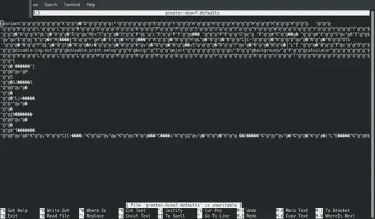

I was under the impression that basically all files in a Unix system are editable, at the very least viewable.
What steps can I take when I encounter a file which looks like this in nano:
screenshot of the binary greeter-dconf-defaults file viewed in Nano
How do I figure out what type of file it really is, if it's a running file and what I need to find out both its code and what the file imports/exports/is dependent on?

All files that live on filesystem or memory are technically editable just gotta use the right methods. You encountered a binary data file, particularly pertaining to dconf database of settings judging by the name in the nano's filename line, and the keyword GVariant in the file itself. Accordingly, you should use dconf-editor GUI tool or dconf command-line tool.
How do I figure out what type of file it really is, if it's a running file and what I need to find out both its code and what the file imports/exports/is dependent on.
Typically you can make use of file command to figure out the particular file type.
