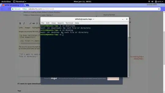

enter image description here If I want to open downloads in terminal like cd downloads, it says no such file or directory.

Unlike Windows, Ubuntu is case sensitive. So it should be cd Downloads. If you start a terminal with Ctr+Alt+T or via the Dashboard your starting point is your home directory /home/<your_userID>. ls gives you the files and directories located here.

It should be cd /home/YourName/Downloads/
