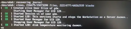

  3. That didn't work either and now the screen just remains black permanently (can't even try to log in). So I try to change TTY to fix this graphical problem.
  4. That doesn't work either, because for some reason after about 3 seconds every time the TTY is automatically switched back to... TTY7 I guess? and for 0.5 seconds the following text is shown (see image) before it blanks again.

UPDATE: OK, suddenly my TTY stopped switching automatically and I could restore usage of the Nouveau drivers (apparently somehow they weren't really selected after all) using information from this post: How to change proprietary video driver using the command line?. I'm now back at square 1 but at least I can still use my computer.
I had to disable hardware acceleration in my xorg.conf to get rid of the black screen issue:
# Add "Option" line shown below to either /etc/X11/xorg.conf
# or /etc/X11/xorg.conf.d/foobar.conf
Section "Device"
    Option "NoAccel" "True"
    Driver "nouveau"
EndSection
