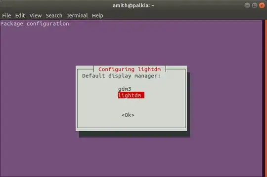

Simply installing the unity-greeter package will allow you to change the greeter from gdm3 to the ubuntu themed lightdm greeter.
Just run sudo apt-get install unity-greeter lightdm --no-install-recommends
During the configuration step you'll be faced with this window.
Press ↵ Enter and you'll get this choice selection screen
Use the arrow keys to select lightdm and press enter
