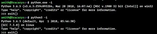

As of 18.04, WSL ubuntu has Python 3.6.5 preinstalled, and you can see both the windows and ubuntu python being used below
