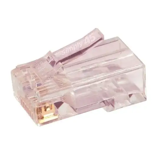

after a ~ week of investigation for me was because of copper RJ45 pass-through!!yes not cable,driver,kernel or network config,it's a copper Believe or not, please try to change it first
the situation:
normally: just running on 100mb or less (not more)
I try(not work):
  • force it by negation (for each side)
  • force it to 1GB (directly) (for each side)
