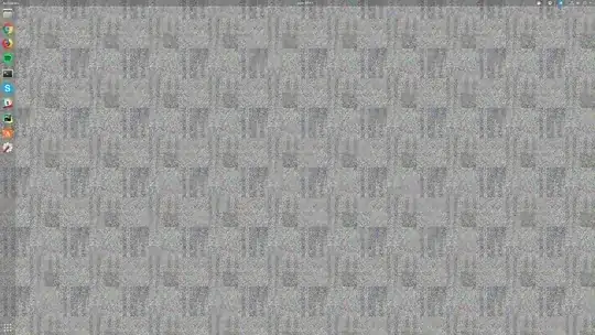

I have the Nvidia 1080ti graphics card, which is just a few days old. Furthermore, I have a clean installation of Ubuntu 18.04 and the latest nvidia-390 drivers installed, using apt:

My problem is that every time I am waking my computer from suspend mode my background turns to this noise pattern (I have solid color set):
I think it is worth to mention that I do NOT have any graphical glitches on the login screen (it was sometimes a problem on Ubuntu 16.04). The login screen works perfectly here.
Any ideas how to solve this issue and where it comes from?

I'm also having a similar problem. I have a Dell/Alienware box with a GeForce GTX 860M, running Ubuntu 18.04.
When the computer wakes from suspend, I also have the problem with a corrupted desktop background, sometimes, white, or with with color "snow". I can fix the problem with:
dbus-send --type=method_call --dest=org.gnome.Shell /org/gnome/Shell org.gnome.Shell.Eval "string:global.reexec_self()"
I have my account set up to not have a lockscreen on resume, and I think that might be relevant. Lock-on-suspend doesn't seem to matter.
EDIT: I've changed my nvidia driver from 390 to 396, and that didn't fix it. But more interesting, if I use Unity desktop, the problem DOESN'T occur. This points a finger at the Gnome desktop software maybe...
I would love to fix this for real!

Another way to work around this problem is to run: AltF2,r,Enter.
This will restart the Gnome desktop.
On some systems, or if you have FnLock off, you may need to run AltFnF2,r,Enter.

I have the same problem too running Ubuntu 18.04.1. I have the nvidia GT220, driver version 340.106. The bug was reported here : bugzilla.gnome.org a long time ago.It concerned Gnome 3.14, and Ubuntu 18 is now running Gnone 3.28. It should be fixed. With the Nouveau driver you don't get that issue.
Here's what Nvidia says about it :
Our current software architecture doesn't preserve the contents of FBOs across modeswitches or power events. As a result, our implementation relies on applications re-rendering to their FBOs every frame. This is a fundamental limitation of our design that will be fixed in the future.
Gnome uses FBOs to not have to render the background on every frames. But the content of FBOs are not saved when the computer enter in sleep mode.

I also have this issue. the workaround for me seems to be to use an image as a background instead of using a color.

This problem still exists up to July 2020. (Using color as Background)
Nvidia Driver Version 440.100, GTX 950 with AMD Ryzen 7, x470 motherboard
Need use Alt+F2, enter R to restart Gnome to solve the issue.

I also had the same problem in Ubuntu 18.04.3 using NVIDIA 390.129. The background showed a noisy image after waking the computer from suspend. I did not find a proper solution but hacked a way to set the proper background running a service when the computer wakes from suspend.
Let's first create the file change_background.sh in /usr/bin:

I've made an workaround: a systemd service that reloads gnome-shell. It fix both wallpaper and widgets garbled on Gnome after a suspend/resume.
Just create a new service file, /etc/systemd/system/reload-gnome.service, with this:

In my case, the problem was solved by switching the GPU driver from proprietary one to the one that came with Ubuntu.
I had the same problem too... But I found a great solution.instead of using pre-installed backgrounds un Ubuntu, use something else...add a photo to background in background settings and use it instead...it will work very well without breaking out after suspend
