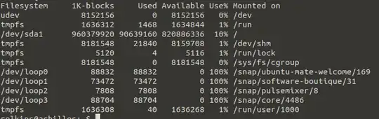

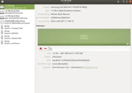

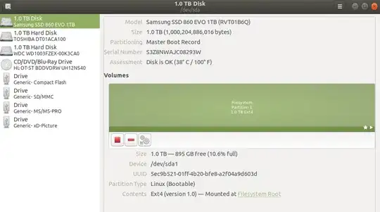

I just did a fresh install on a 1 TB SDD. Install is fine. I checked the disk using Disks and I see the percentage full continuously increasing. Why is this happening?
I noticed that I don't see a swap partition - could that be the reason?
Now the full space is up to 11.9% and keeps increasing.
