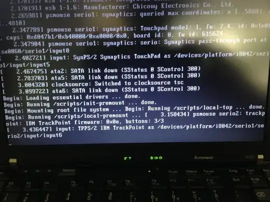

Booting Ubuntu in recovery mode got stuck always at the same point:

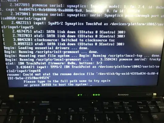

loading some drivers, I guess? loading some drivers, I guess? here I discovered that, if I wait long enough (>5 mins), another prompt appears:
press enter to boot the system press enter to boot the system When Pressing Enter, the recovery mode menu does indeed appear.

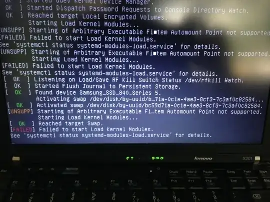

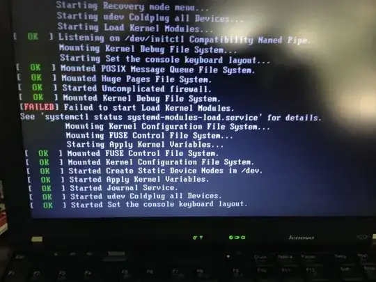

When I select network here, the system gets stuck again showing first this:
failed to start load kernel modules failed to start load kernel modules and then this:
failed to start load kernel modules - again failed to start load kernel modules - again where it stops doing anything.

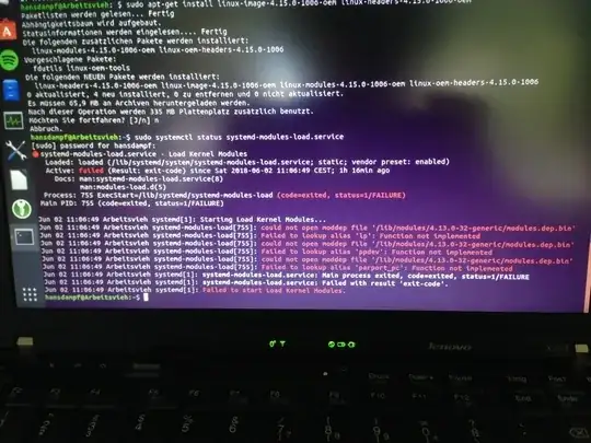

After reading through this Guy's post who seems to have had a very similar problem, I got the following output for sudo systemctl status systemd-modules-load.service:
many red lines many red lines Too many red lines for my taste, unfortunately, I'm too inexperienced to get what it wants to tell me. Unfortunately, the answer that helped the guy who posted the question above didn't have any healing effect on my system.
