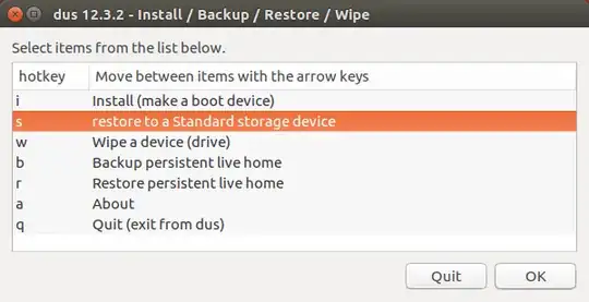

You can use mkusb to restore a cloned USB boot drive to a standard storage device with an MSDOS partition table and a FAT32 file system. I think this is what you mean by format.

  • Use mkusb to restore to a standard storage device
