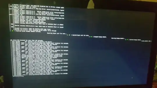

Finally I created a new partition sdb8 efi and then Installed Linux successfully. But at the end of installation it asked me to restart and I accepted. But before it done, It gave me this messages as you can see completely on image:
"echo 0 > /proc/sys/kernel/hung_task_timeout_secs" disables this message. info task xorg blocked xxx for more than 120 seconds

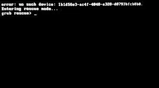

After a forced shutdown I got this error message when I started my PC again:

I tried this .... working ... open terminal and start typing
sudo nano /etc/sysctl.conf
Add the following line at the end of the file:
kernel.hung_task_timeout_secs = 0
Save the file and run the following command to apply the changes without rebooting:
sudo sysctl -p
