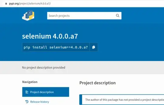

To install a specific version go to pypi.
Find a version you need from the Release history and on the example of tag 4.0.0.a7 run:
pip install selenium==4.0.0.a7
The same works for Ubuntu 20.04.
