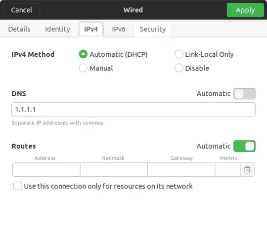

I had the same problem. To solve it, I changed my DNS server settings and now everything gets resolved really fast (apt update, Firefox startup, git, etc.).
Change DNS server settings:
If you are using a wired network, go to Ubuntu Settings > Network > Wired > Options > IPv4. Make sure IPv4 Method is Automatic (DHCP) and choose your DNS server (I personally use https://1.1.1.1/dns/). You can do the same for IPv6, make sure to put a valid IPv6 to the DNS server.
wired config
If you are using a Wireless connection, go to Ubuntu Settings > Wireless > [YourWifi] > Options and follow the same instructions.
