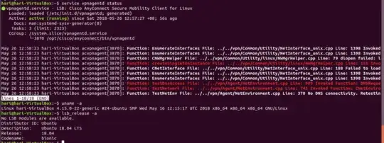

ISSUE: Unable to open "Cisco Anyconnect Secure mobility client" on my Ubuntu 18.04 LTS after the complete installation.
I am able to see the icon on the application menu; but, when I launch the app it doesn't open. Below is the screenshot \ logs for your reference:

I had the exactly same problem, the VPN was working but couldn't see the GUI, I found that is because of some missing dependency (libpangox-1.0-0 and libcanberra-gtk-module), try installing it:
sudo apt install libpangox-1.0-0 libcanberra-gtk-module
You may check if you need anything more or have other errors by running the UI executable, mine was installed on
/opt/cisco/anyconnect
You can run bin/vpnui and check what error you may have, hope it helps!

I also installed sudo apt install libgtk2.0-0 which fixed the issue
