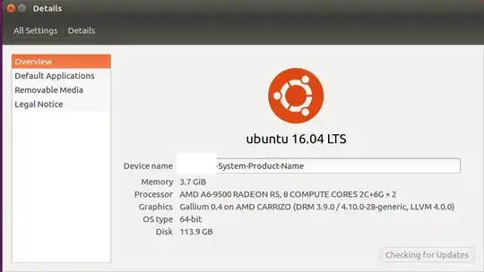

Below is my system configuration
enter image description here Motherboard
