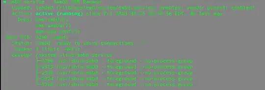

Output of systemctl smbd status
● smbd.service - LSB: start Samba SMB/CIFS daemon (smbd)
Loaded: loaded (/etc/init.d/smbd; bad; vendor preset: enabled)
Active: active (running) since Fri 2018-05-25 16:43:19 -03; 13s ago
Docs: man:systemd-sysv-generator(8)
Process: 1000 ExecStart=/etc/init.d/smbd start (code=exited, status=0/SUCCESS)
Tasks: 3
Memory: 23.2M
CPU: 233ms
CGroup: /system.slice/smbd.service
├─1012 /usr/sbin/smbd -D
├─1021 /usr/sbin/smbd -D
└─1080 /usr/sbin/smbd -D
May 25 16:43:18 NAS systemd[1]: Starting LSB: start Samba SMB/CIFS daemon (smbd)...
May 25 16:43:19 NAS smbd[1000]: * Starting SMB/CIFS daemon smbd
May 25 16:43:19 NAS smbd[1000]: ...done.
May 25 16:43:19 NAS systemd[1]: Started LSB: start Samba SMB/CIFS daemon (smbd).
I did a reboot on the server, waited a little bit, and then a login using date; ssh SeverIp using my Debian notebook and quickly put my password. The date on the second line of the systemctl output above is just 3 seconds after the one on login.
