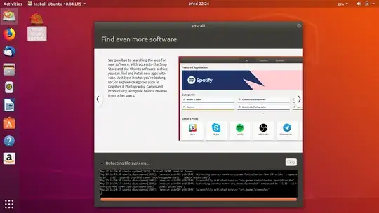

I tried many time to install 18.04 LTS, but all time shows it takes more than one hour to detect the file system. Then I restart the installation.

When I start the live CD there is a error message
[Firmware Bug]: TSC_DEADLINE disabled due to Errata; please update microcode to version: 0x22 (or later)
The recommended version no(0x22) may be different, I can't remember.
Is my installation stuck for this bug?
And there is a solution for this bug message in [Firmware Bug]: TSC_DEADLINE disabled due to Errata - what should I do about this? where they propose to use sudo apt-get install intel-microcode. Should I install this in liev CD?

This has been a problem for years. It is caused by the set -e at the top of /bin/partman-commit. When the unmount step fails (because there is a file system that is hosting the loop device on which the installation media is being accessed that is in use) partman-commit exits immediately. It never gets to execute anything else in /lib/partman/commit.d, and it never signals ubiquity, the installer (its last step). So ubiquity hangs forever.
Workaround:
Edit /bin/partman-commit and change the set -e to set -x
