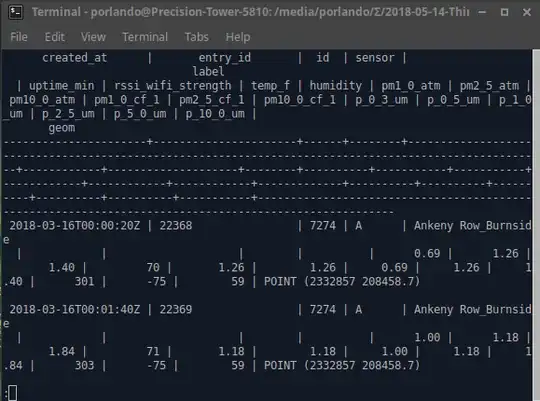

I'm trying to get my psql pager output to look nicer.
I've added the following to my ~/.bashrc
export PAGER='less -S'
And I've added these line to my ~/.psqlrc
\x auto
\pset pager on
\setenv PAGER less
Current output:
Desired output:

\setenv PAGER less in .psqlrc overwrites the environment variable with an undesirable different value (without the -S option).
Either remove it, or change it to \setenv PAGER 'less -S', or create a new environment variable LESS set to -S
Note that even when less is not called with the -S / --chop-long-lines option, hitting the right arrow key will scroll horizontally and temporarily display lines without wrapping them.
