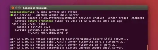

On Ubuntu Desktop:
First check the status of the service:
sudo service ssh status
should show: - Active: active (running) If it's running there's no need to restart it. If you still want to restart it, Ubuntu calls the service ssh, not sshd.
service ssh restart
