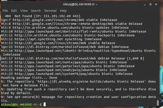

I tried installing WINE via the terminal but I was unable to install it. Since then I am constantly getting this error.
terminal screenshot - winehq repository does not have a release file
What should I do?

I set my line in /etc/apt/sources.list
andrew@big-red-wired:~$ grep wine /etc/apt/sources.list
deb https://dl.winehq.org/wine-builds/ubuntu/ artful main
# deb-src https://dl.winehq.org/wine-builds/ubuntu/ bionic main
Things work just fine.
HTH, Andrew.
