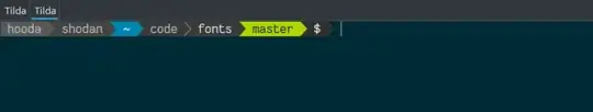

I'm using powerline-go to generate the bash prompt. It works fine in the tilda (also Konsole), like so:
Which is fine. However, the moment I open tmux it becomes messed up: enter image description here
Basically, the segment seperators end up shown as underscores. This is pretty annoying, and I'm not able to understand why tmux refuses to render my fonts the same way as a regular terminal.
I'm using Fantasque Sans Mono, but I see the same behaviour with other fonts.
