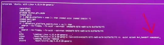

  1. Go into the GRUB menu and select Advanced options for Ubuntu.
  2. We will edit the startup options, so press e.
  3. On the end of the line starting with linux /boot add a word: nomodeset
I have no idea why this works but it does. Can anyone explain it?
