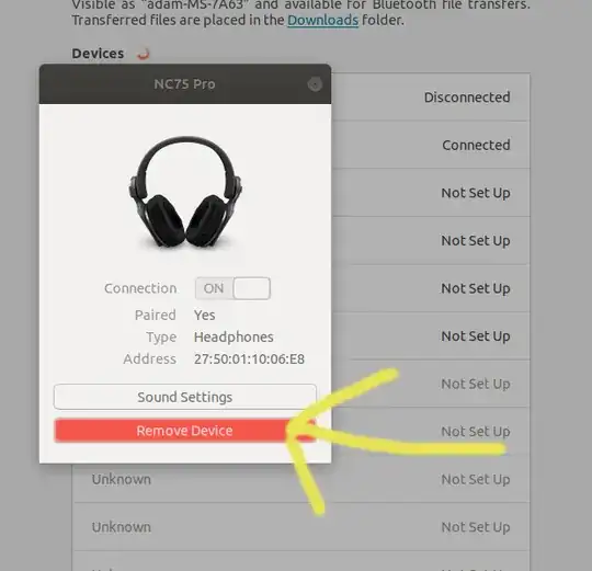

I also have this problem with my NC75 Pro headset from time to time. Dark Singularity's answer and ubuntu upgrade did not work for me.
The only workaround I found is to remove the device and install it again:
If it won't connect at all, maybe you have to update the driver as explained here.
