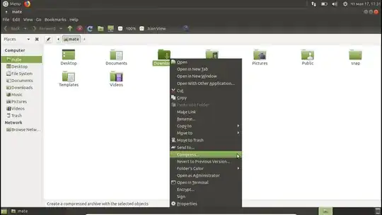

  2. Make right click on the folder to arhive
    selecting Compress action in Caja

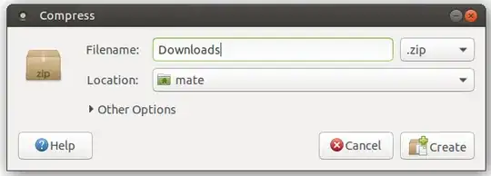

  3. New window named Compress will open
    Compress window

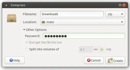

  4. Click on Other Options and select password capable archive type in the right part of Filename (such as default .zip, .7z, .cbz, .ear, .exe, .war) then enter password in Password field and click Create
