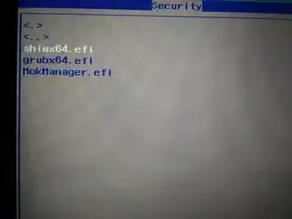

Turn on Secure boot from under Boot Tab.
  • Go to the Security tab and look for Select an UEFI file as trusted for executing and select enter
  • Navigate to shimx64.efi and press enter.
Might be something like this.
Security menu in UEFI settings
Save changes and exit. Now you should be able to boot.
