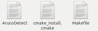

I recently updated my Ubuntu from 16.04 to 18.04, and one problem is the icon for the executable is the same as the one for a text file. (ArucoDetect is an executable, and others are usual text files)
In Ubuntu 16.04, the executable have it's own icon like
executable
How can I configure Ubuntu 18.04 so the executable can have it's own special icon?

If you have problem than you can find gcc and add line -no-pie It is default executable because Ubuntu 18.04 has problem with pie that is why position independent executable. Just no pie! Than it works fine for me.
This answer exists solely of a continuation of Piggybacking off of Jens' answer of using -no-pie as part of GCC builds...
This is a bug caused by Position Independent Executables (PIE). PIE is a security feature in modern versions of Linux that randomizes memory addresses as well as slightly changes file structures. PIE binaries are different from "standard" Linux binaries because PIE binaries have a different type - most systems (notably, file) will treat them as a Shared Library file instead of a plain-old executable binary:

Ubuntu's file browser (Nautilus) doesn't do its own filetype processing (it instead elects to use libmagic/file/etc.). As these upstream libraries are broken and are unable to detect PIE-built binaries properly, Nautilus is not able to show them as executable in the GUI. The system, therefore, elects to treat them as though they are any other shared library (that is, as a non-executable).
However, this problem can be mitigated away. A developer can compile a binary using the -no-pie option to disable PIE (although this does harm security a little bit). This will allow libmagic/file to see the binary file as an executable binary and pass that data on accordingly to Nautilus. Alternatively, a developer (or an end-user) may create a .desktop file pointing to the binary. This is considered the "preferred" workaround by the GNOME team, as it allows addition of metadata and icon files, creating an overall prettier user experience.

@dim I believe that you'll find that compiling with the -no-pie switch results in a different header
mimetype guesses the appropriate mime type based on the contents of the file. For ELF files (most compiled binaries and shared libraries), the header contains a field e_type which identifies its type. If it is ET_DYN, then mimetype will treat it as a shared library.
By default, gcc/ld will produce binaries which set e_type to ET_EXEC, which get detected as application/x-executable
which causes the mimetype to be guessed diferently as explained by this StackOverflow answer hence the different icon.
