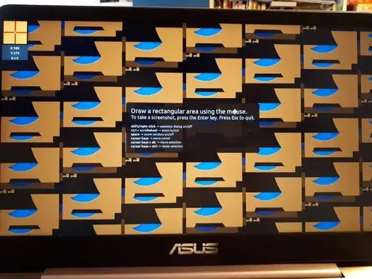

I have Ubuntu 18.04 (updated from 17.10 where I had the same problem), and when I use it with Wayland, I cannot use any screen capturing/recording apps. For instance, when I try to take a screenshot with Shutter, I get a weird pattern instead of what's actually on my screen: shutter
I know I can just switch to GNOME/Ubuntu on Xorg, but sometimes that's not an option. Is there a fix for this? Or a certain app that works as it should on Wayland?
The default Screenshot (gnome-screenshot) application should work fine. Search for it in the "Activities" overview or use the Prt Sc key. You can capture your whole screen just by running
gnome-screenshot
For the GUI, run
gnome-screenshot -i
Run
gnome-screenshot -h
to see all possible options.
pomsky
  • 70,557
I use grim -g "$(slurp)" - | wl-copy to take an area of a screen and put it in clipboard.
Works perfectly in Sway on Arch Linux.
