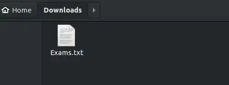

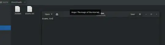

I have searched a lot about that & the only way I found is to create a file named .hidden & put the file names I want to hide in separated by a break. This method seems to be not working for some reason even for 1 file.
Here I add the Exams.txt file as the one I want to hide
then press Ctrl+H and f5 & that's what I get, only .hidden file disappears.
So, any ideas? am I doing something wrong? Does this method requires something to be installed first that is not installed by default ? Or this is deprecated method that no longer works?

OK I have solved it guys thanks everybody.
It seems like my problem was HOW I create the .hidden file.
it doesn't work if I copied any file (instead of creating a new one) & renamed it to .hidden and delete it's content & put the files names I want to hide in it.
I used to copy a .txt file & do that & that was my problem apparently.
Seems like I MUST create a new file using the terminal
touch .hidden
command to work.
Sorry for the disturbance.

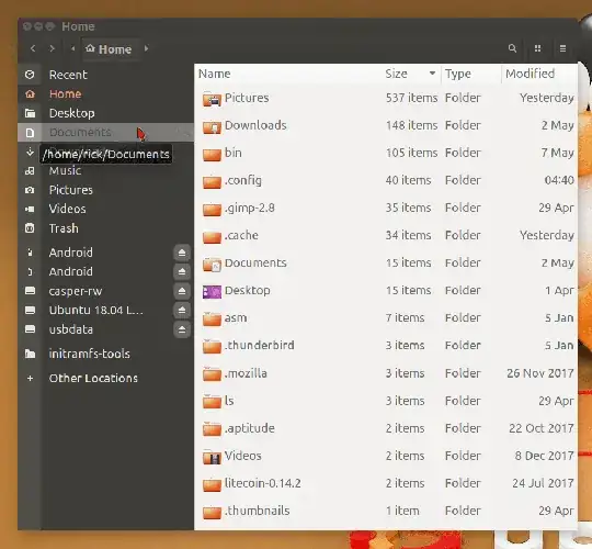

In Ubuntu 18.04 controlling display of hidden files is no longer in the preferences menu as it was in Ubuntu 16.04. It's been moved to a drop down menu on the top right corner of the window:
This setting is "persistent" and will the same setting across reboots.
