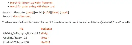

  1. Visit packages.ubuntu.com.
  2. Enter missed file name in Search the contents of packages (in our case libz.so.1.2.8) specifying target Distribution (xenial in our case) and CPU Architecture (amd64):
    search options
  3. Click Search, it will show the results page:
    search results
  4. Then click on the zlib1g link

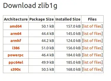

  5. In Download section click amd64:
    download <code>zlib1g</code>
