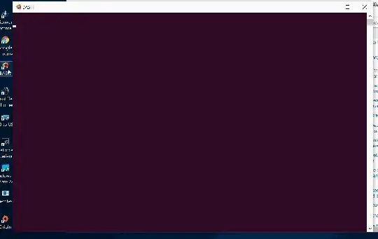

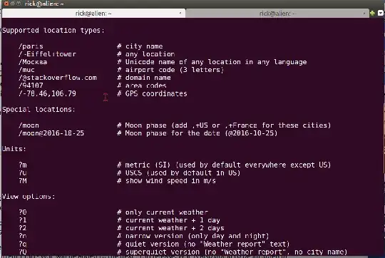

Ubuntu in Windows (WSL - 2017 Fall Creators Update) is definitely slower than "Pure" Ubuntu in Linux environment.
For example screen painting takes many times longer in Windows 10 versus Ubuntu 16.04, ie you can actually see the cursor move in Windows 10:
It takes about 5 seconds for the WSL Bash splash screen to paint. By comparison it is about 1 1/2 seconds for the same splash screen in Ubuntu 16.04:
