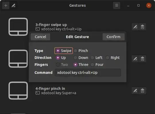

You can simply download "Extended Gestures" from Ubuntu Software! but, it depends on your PC and doesn't work properly for all PCs
OR if you prefer the hard way, install "Ubuntu touchpad Gestures":
  1. Download the zip file from this link which contains the installation script
  2. Run the following command in the terminal to install the dependencies and download, compile and install the latest source code:
    chmod +x gestures-install.sh
    sudo sh gestures-install.sh
  3. After rebooting to complete the installation, open "Gestures" from the application menu.
Now, you can customize your own gestures!
screenshot
Use the following command to remove it using the same script:
sudo sh gestures-install.sh --remove
