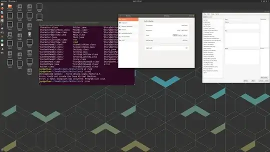

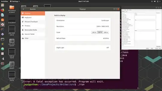

Screen Scaling Factor 200%:
Screen Scaling Factor 100%:
