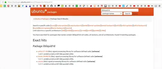

So in this case, a user might search and find under https://packages.ubuntu.com/search?keywords=libliquid1d that this library exists within the Ubuntu ecosystem only for Artful, Bionic and Cosmic releases. So how about installing for other distributions?
Ubuntu packages search result
This is the question I have. What hacks are known/popular in the community when that case happens? I am interested in a generic method that works to install missing dependencies in Ubuntu distributions, if it exists. I hope my question is specific enough.
