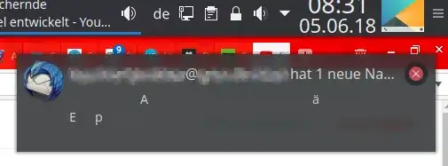

Update: I installed Kubuntu 18.04 and (while not showing up at the beginning) it also sports the missing characters problem: missing characters in a notification
So it seems reasonable that maybe the graphics card driver may be the problem (it is the same version 390 in both Kubuntu versions):
