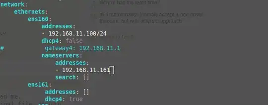

I tried to configure netplan, using guides like the one above and the following:
-1
When I edited the .yaml file and executed: $ netplan try it failed.
In my case I could solve it leaving the space that had the original file: This is on Ubuntu Server 18.04.1 LST. Backup the original file before edit it. Good luck.
