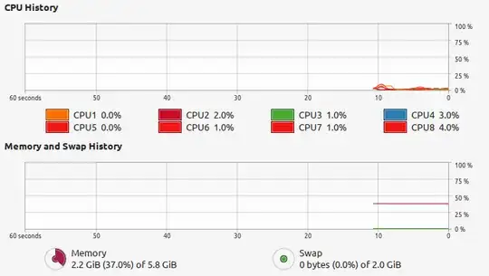

I don't have any high CPU usage issue:
CPU Uage

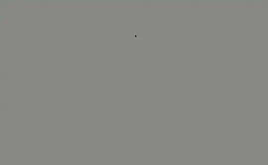

Screencast

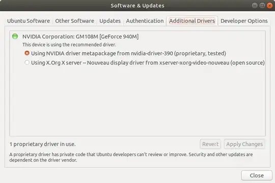

I was experiencing a lot of lag on the splash screen with 18.04 and wanted to put this here as another solution. In my case I had been using an open source graphics card driver (Nouveau) instead of the Nvidia proprietary and it looks to have been the cause of the issue.
  1. Go to Ubuntu Software app.
  2. Open Software & Updates from the app's dropdown in the task bar.
  3. Go to the Additional Drivers tab and see if you aren't using the recommended driver for your graphics card.
screenshot
Once I switched from the Nouveau display driver to the Nvidia driver metapackage 390, everything ran much more smoothly.
