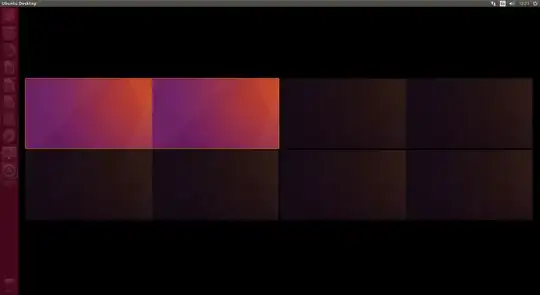

Although a bit dated, I love Unity for how it lets me use up to 4 separate workspaces with more than one monitor. I sadly noticed this when I updated one of my computers to 17.10 (and now 18.04) and switched to Gnome.
In Gnome Shell there is apparently no way to have two monitors, place windows on every monitor and switch to another (virtual) desktop/workspace with different windows or empty space. Instead Gnome pulls the windows of applications on non-primary monitors along as you move from one desktop to another. I looked into a few Gnome Shell extensions but none seem to address this.
Since I will upgrade my LTS desktops in the coming months what options do I have in 18.04 besides sticking with Unity 7?
