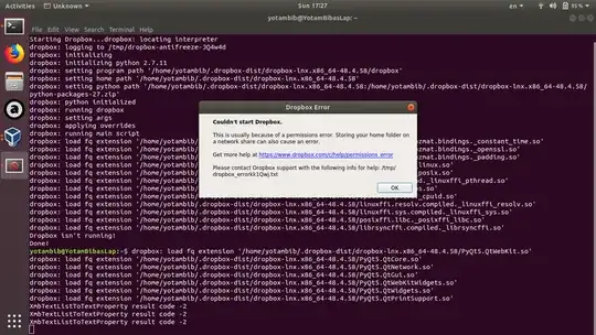

It is working well in Ubuntu 16.04. After upgrading to 18.04 it refuses to start.
Anyone has any idea ?
