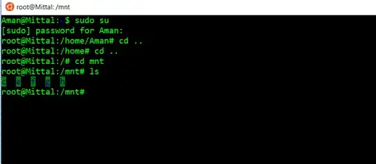

  4. Navigate to the folder destination and use rm -r "Folder_Name". For more info how to navigate in Ubuntu Terminal, see screenshot below.
