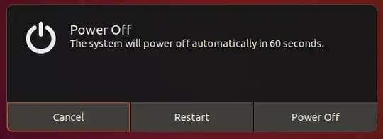

If I manually run gsettings set org.gnome.settings-daemon.plugins.power power-button-action interactive GNOME asks me what to do.
Power Off
The system will power off automatically in 60 seconds
Cancel | Restart | Power Off Confirmation dialog on physical hardware
It is expected behavior.

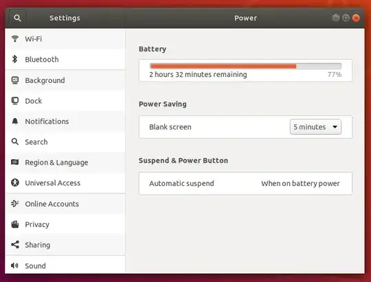

But currently there is no such option in GUI (gnome-control-center power), request for enhancement was filed as bug 1769614 :
gnome-control-center power on physical hardware

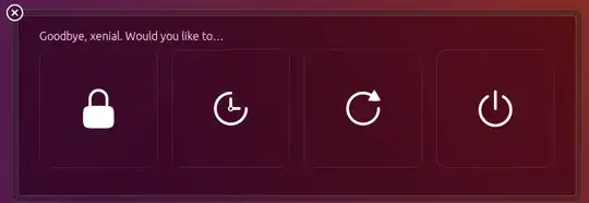

I expect that Ubuntu 18.04 LTS with default desktop would ask me about action on pressing power button as Ubuntu 16.04 LTS do:
Ubuntu 16.04 LTS asks for action after pressing power button

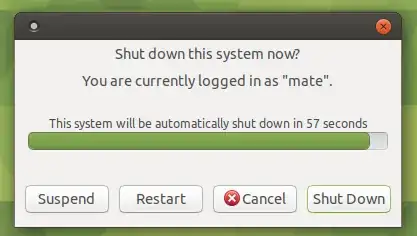

or as Ubuntu MATE 18.04 LTS do:
Ubuntu MATE 18.04 LTS asks for action after pressing power button

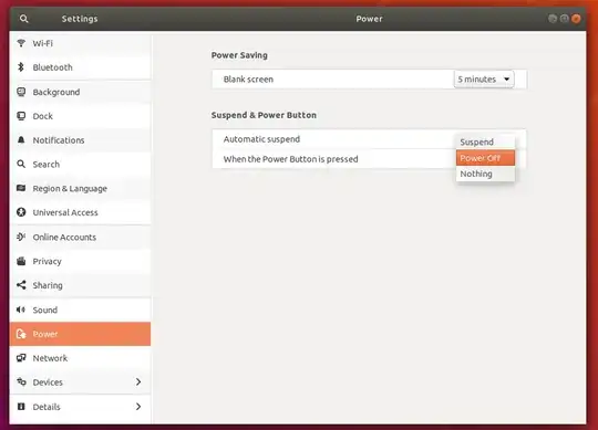

Once more interesting thing that I do not have When the Power Button is pressed in VM (it is bug 1769623):
gnome-control-center power in VM

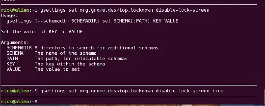

I borrowed this .gif from another answer I wrote. It shows how the lock screen option was missing and how to bring it back.
