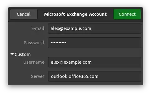

Assuming your alex@example.com is a Microsoft Outlook for business, set your email and password as usual. At the custom fields:
ubuntu-accounts
