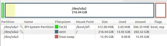

Here's also what I get from gparted enter image description here

It looks like you have errors on the USB drive's filesystem. If you can get to a state where the device (here /dev/sdd) has been created, then, as it is not mounted, run e2fsck on it to automatically fix any errors, e.g.
sudo e2fsck -y /dev/sdd
Look at the e2fsck man page for description and options. And if e2fsck didn't work check all the physical connections, Inc USB cable and any other parts in the chain, if any.
