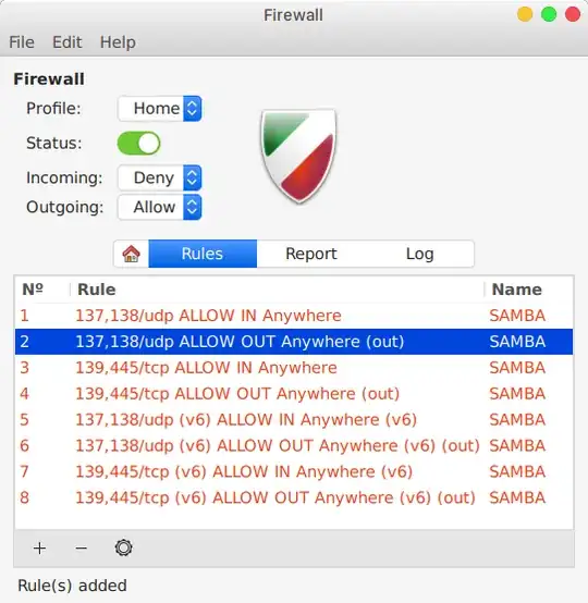

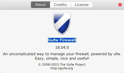

I encountered this issue on a Ubuntu 18.04 system that had installed SAMAB, via sudo apt install samba, with the application "Gufw Firewall" activated.
gufw_about
To overcome this issue, after opening the gufw application, i.e.
gufw

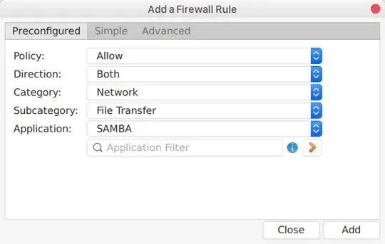

I clicked on the Rules button, followed by the + button, and made these settings:
Added rules
After pressing the Add button, the firewall rules that allowed SAMBA share were created and reflected in the Rules table of gufw. gufw with SAMBA rules
Thereafter, in nautilus --> Other Location --> Networks, my machine name would appear there and the machine's shared folder(s) that was created with nautilus-->Local Network Share became detectable by other systems in the same network.
