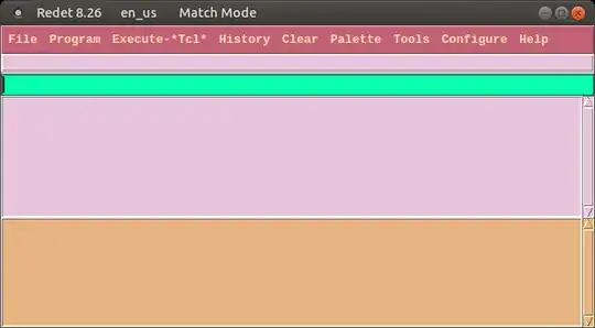

After these actions redet is launched normally:
redet on Bionic
