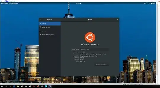

It works fine with my desktop!
picture - success login xrdp
The good news is it works good with Nvidia drivers so far.

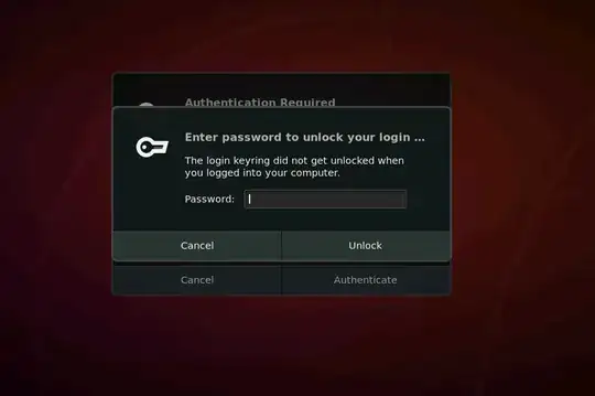

  2. It would ask you to input password after login once again.
    picture - password again
