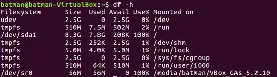

But now when I run my VM, I still see that my disk size remains the same and not updated.

I used GParted to modify the Linux native partition. I followed Use GParted to increase disk size of a Linux native partition.
