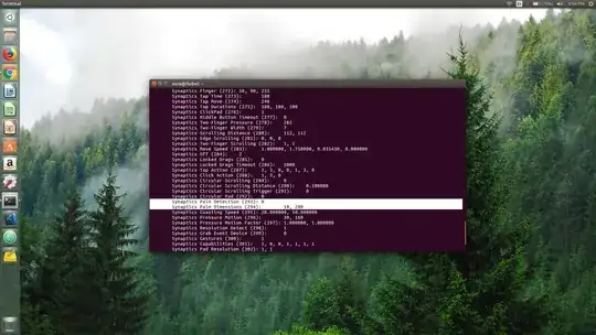

I checked the Synaptics touchpad configuration using terminal, but what I saw is that palm detection was set to 0 like in the picture below.
From my experience, 0 means 'FALSE'. This means NO PALM DETECTION. I would like to set my Synaptics touchpad to recognize my palm.
